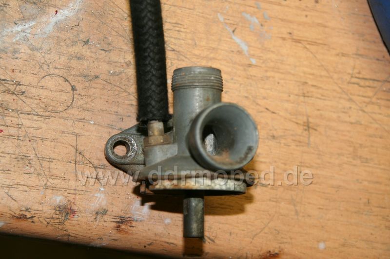

Ori: No, its not the right way!! In the top-piece of carburetor you have an input (show photo). Only there you can get the fuel (100 percent fuel to 25 percent of oil!!!) put in. You must (I`m shure, you must mixed it in Israel) mix this!! Without Oil in fuel you will destroy the engine.
Thats at first. The filter is only used for air. In the underground of the carburetor you have a swimmer. This part makes a currently base of "fuel in" of fuel(with the air from the filter).
Wait a moment, I must search for a link to "how is working this carburetor"
I have founded it....here

I put the fuel 95 octane @ 4% oil for 2 stroke engine
The carburetor get the fuel properly

Unbelievable I fix the carburetors again clean the plug and it start
And don’t stop like hell " Hölle"
