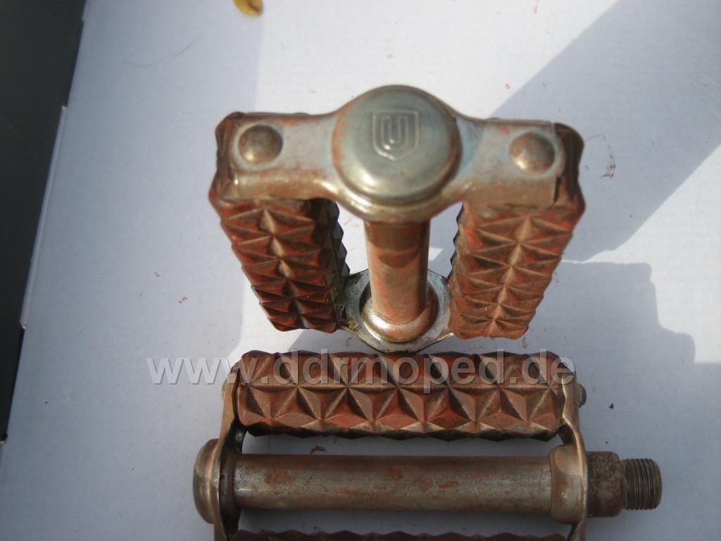

The pedals/treadles are not the right for Simson. I don`t know it, what type this it.

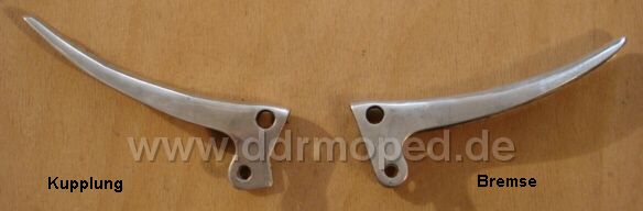

You cannot use the handle on your photo for the left side. Left side is gear change!! and the handle looks diffrently. Your handle is for right side>front brake.

The pedals I do have the original as shown in page 3 last photo.

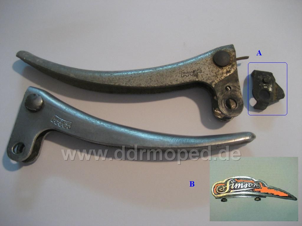

About the left handle Norbert I mark the item A if you mean to that.
And I forgot the missing symbol Simson B

hello,
the pedals are from West Germany, the Company called Union.
greetings René

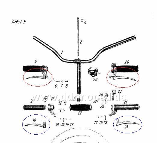

I'm sorry that I make you to busy with me ermm.gif but I check it again. you say that there a deference between 18 and 23 unsure.gif number 18 i have the origenal

look the difference:
Geschrieben am: 30.03.2008, 11:31
Ori,
Wolfgang showed it. You must have the left handle because the gear change is there. The little bit of difference in handle is the locking mechanism for the gear change.
Without this handle it dos`nt work.
regards Norbert
