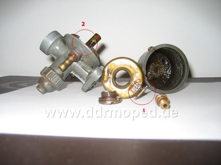

Thanks for the quick respond! my name is Ori, im 50 years old, live in Israel. I have the bike for 30 years. now i want to restorat the bike. The Piston and the Rings i fixed already few years ago, and i have a problem with the carboretor (1) The length of the pin is correct (2)? what can i do with the base of the pin? Thanks in advance.
| NorbertE |
Beiträge: 14959
Now I´m already down....from Israel  Wellcom!! Für meine deutschen Freunde: Wo bist Du her? ist in english: From where do you come from...  Ori, I think, your problem ist easy. On your photo is not showed the end of part 2. The "Hauptdüse", The "major-jet is lost!!! We have it!! But bevor you must cleaning the complete Parts correctly! It is urgend!! I think, we all can help the old SR1 hit the steets of Jerusalem Best regards Norbert
