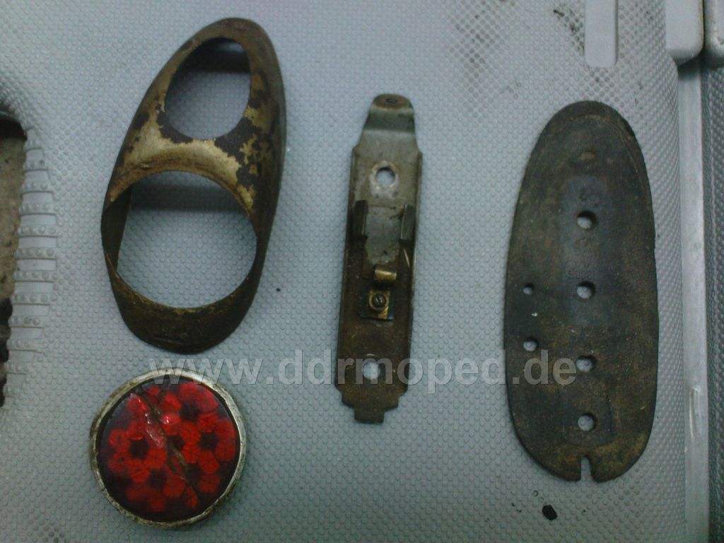

The photo below shows left the old rearlight ( without groundplate, I dosn`t have it here), middle the new rearlight an right the groundplate for new light. The groundplate for the old light is a little bit smaller, but have also only one of lamp.
I ask the guys here: Do anybody have in short time a photo of the old groundplate?
in german: hat jemand auf die Schnelle ein Foto des Lampenträgers vom alten Rücklicht?

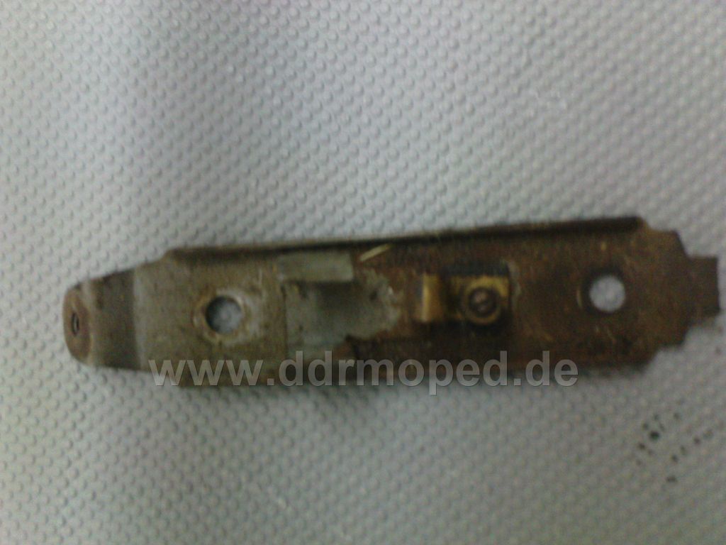

I was just fast in our basement und took a foto of it.
Here it is!

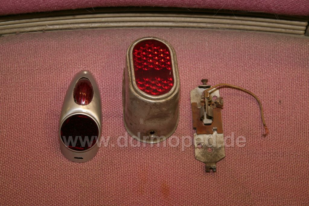

Geschrieben am: 06.11.2008, 16:51
Beiträge: 4063
Mitgliedsnummer.: 400
Mitglied seit: 29.11.2006
And one more.
