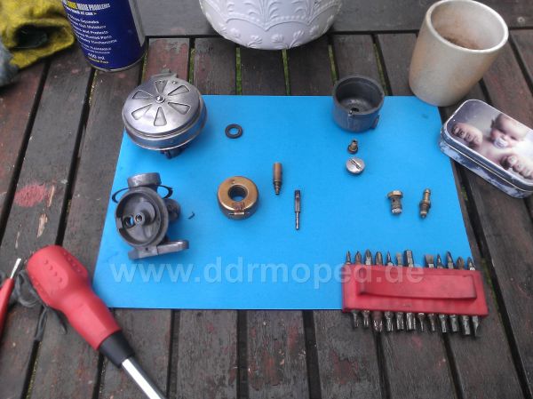

Hi again Victor, yes MOT's for everything here except pre 60's as with the Nsu Quickly i have in the first pic, the SR2 is 1964 so will need one but its not so harsh for any pre 77. I have taken your advice and have been out and removed the carb and stripped it down parts as per pic. I have as you suggested used glass paper on a flat surface and sanded down the inlet side which was still warped (pics to follow) and is now nice clean and flat, the tickle pin is complete but there looks as if there should have been a washer at the bottom of it which i will check against the diagram in a min otherwise although the internal parts are worn and old i have cleaned them up and am going to reassemble this afternoon. and hello to Germany ( i used to live in Munster in the 80's) smile.gif

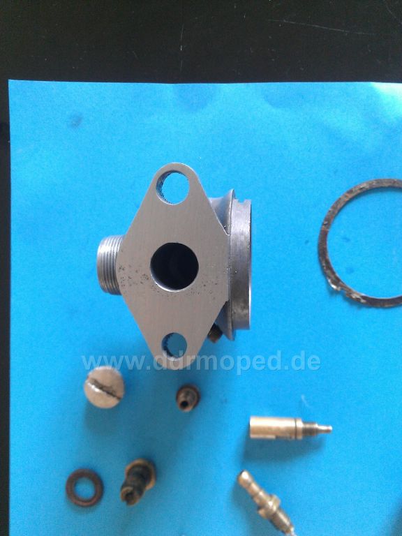

and the carb inlet after sanding down.... Mark

yes looking at the diagram it seems to be missing a spring from the bottom of the tickle pin so im going to see if one may fit from a ball pen as it looks about that size

Hi Honky, Yes, you can use a part of a spring from a ball pen. It works but I´m shure that is not the reason why your carb dos`nt work.
A little help (use a translator) is here:
https://www.ddrmoped.de/forum/index.php?showtopic=23035

Hi Norberte, i tried it today and your right it isn't, i rebuilt the Vergaser/carb and still no joy a bit of the problem is that one of the head studs had been drilled badly and messed about with i have tried to cold weld a new stud back in with no joy. and i think its drawing air in from the manifold. I did think of trying to fit a walbro carb as its lighter and it works differently but im slowly starting to think that this will also be a waste of time and money so i have been in contact with a guy on ebay.de for a replacement engine. the one i have i can strip for spares.and at 100 euro's with postage it is possibly the best plan. Either doesn't matter to me as i hold a full bike licence. the carb by the looks of it is shot and no good so that will have to go either way. I do want to increase the power so i can keep up with modern day English loonie drivers. I do love the looks of the SR2 its a very cool looking bike. sorry for the late replies it was my wife's 47th birthday today and we went out. thanks for your reply. Mark smile.gif

Any ways are possibil to fit your engine with the carb:
-a used original carburator BVF 121-x from ebay. Its available any time and not so expensive.
- an other carb in example from BING or AMAL. This must have 12 or max. 13mm diameter airhole trough. You can use a modern air filter also.
You must be shure, that nothing of air is running in on the place between the carb and the block!! This engine works like a airpump! Also you must the carb isolate of thermic base on this place. In original the big plastic disc is the thermic isolation. Do not forget!
Both side (carb and block) must be exactly flat (air!) Look at the link, I`ve sended.
And of course, this problem with the head studs is`nt new.I also fixed on one motor one of the stud new with cold welding, with aluminium fluid based of 2 components. It works!
Show me a photo of this place on the block, please.
